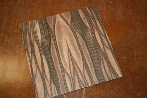

Well, I have a client that really wanted one. His back and sides are Special Grade Mun Ebony from AC. Incredible stuff. But I didn't have enough in the set to get a ring. So Bob C set me up with some that was 1.5" x .5" x 36". Great for binding but I couldn't figure out how to get a rosette ring out of it. The client specifically didn't want a segmented rosette as I showed him some samples and he didn't like them at all. So this is what I came up with.

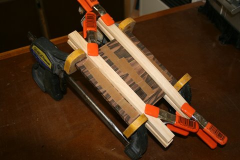

First I double bookmatched some of the plank to get a 6" square piece. I took two pieces 6" long, resawed them, bookmatched the center two, and matched the outer two to that. I guess it's not really a bookmatch as that would fold like an accordian from one piece.
This is what the resulting glue up looked like.

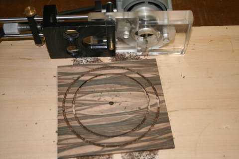

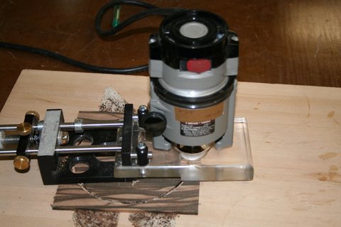

I routed out the ring with my small circle cutter.

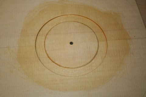

Then the matching channel.

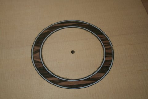

Here is the ring dropped in with teflon strips where the shell will go.

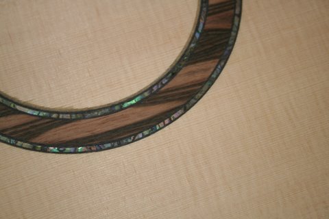

And with the shell added.

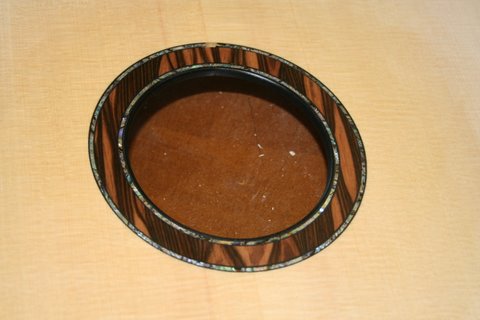

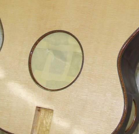

Then finalized with an ebony soundhole binding. And she's done.

Can you explain binding the soundhole a little more? How do you do it and what purpose does it serve? Do you install it like regular edge binding or........

PostPosted: Fri May 11, 2007 7:10 am
Well, my soundholes have a patch behind them that runs cross grained.
This doubles the thickness of the soundhole area. Then the binding is simply bent and edge glued to the side of the soundhole.

PostPosted: Fri May 11, 2007 8:01 am
Hesh, here is one of my standard wares.
